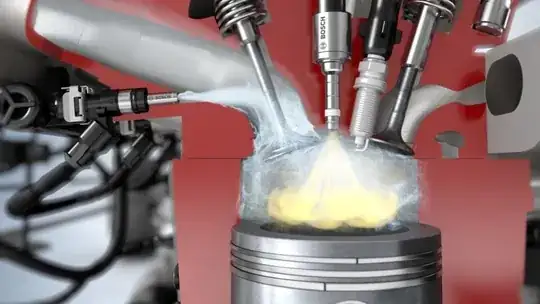

Bosch recently made waves when it announced plans to offer the M4 GTS' water-injection system to other mass-produced vehicles.
Water Injection Cutaway
Now water injection isn't a new concept; Bruce Crower put the six-stroke engine in the limelight about a decade ago, but articles were quick to point out that it would require a significant supply of clean water:
Preliminary estimates suggest a Crower cycle engine will use roughly as many gallons of water as fuel.
What prompted this question is Bosch's claim that the water tank needs to be replenished once every 1800 miles (roughly 2900 km).
That is an order of magnitude less water consumption. How come?
From the video in the linked article, it doesn't look like they are doing any recycling/filtration of the water.
Of course, it could be that the amount of water required is teensy-weensy, but I don't see how it would explain the order-of-magnitude difference between this Bosch design and the Crower six-stroke.
