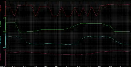

I drove around the parking lot a little faster than a brisk walk / slow jog and noticed that the dash speedometer seemed to stay on zero. The reading from the ECU bounced between zero and 7 - 9 km/h, like this:

Here's a graph of roughly the same data:
Speedometer Readings

I read that vehicle speed sensors will not generate a signal at less than 3mph/5kph. This is mentioned on a site describing what to do about P0502 codes and in Tim Gilles book "Automotive Service".
My speed during most of this test was hovering right around 5kph. According to these sources, every time I drop below 5kph, the sensor will stop producing a signal and effectively read zero speed. I'm wondering if maybe this graph is actually OK?
