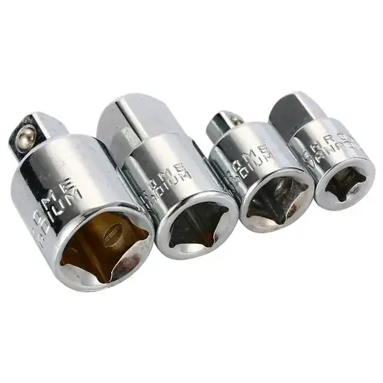

Get both metric and imperial-sized sockets. Buy them as sets, it's cheaper. 1/4"-drive is only good for "screw-sized" fasteners, believe me, I've broken many 1/4"-drive sockets, reducers and ratchets. Your best bet, as Dlu pointed out, is a 3/8"-drive set. They are strong enough for most automotive things outside the suspension and wheels. I've seen 3/8"-drive sockets as small as 10 mm, anything smaller you would need 1/4"-drive or an actual box wrench could do. If you intend on doing anything suspension-related or even just taking your wheels off, get a 1/2"-drive set. See picture below if you're fuzzy on what we mean by drive size (it's the size of the square hole you fit the ratchet into: picture shows 1/2"-drive, two 3/8"-drive then 1/4" drive)
Drive size

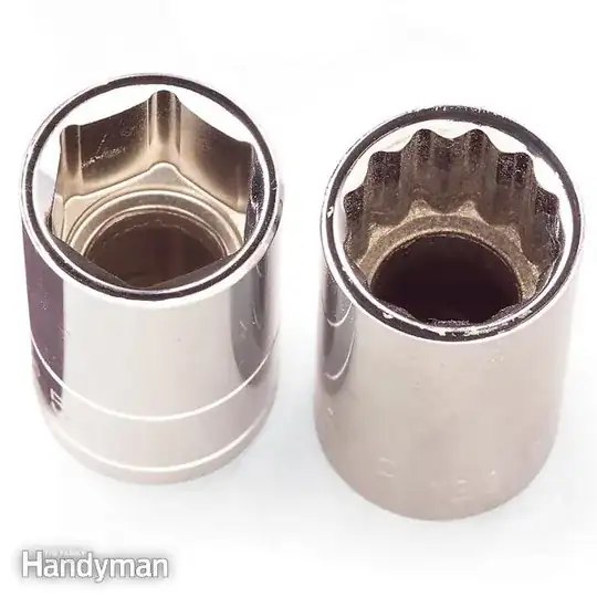

As far as the sockets themselves, Dlu touched on the 6-point and 12-point variants. Get 6-point sockets, all 12-point sockets are good for is removing rounded bolts, or making rounded bolts. See picture below.
6-point vs 12-point sockets
