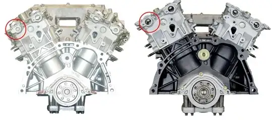

One of the major things which is different about the "Rev-Up" motor is it has variable valve timing on both the intake and exhaust cams, where the regular VQ35DE motor only has a phaser on the intake side. You can readily see where the cam sensors for the engines are at here in this image:
This is the back side of the engine, with the regular VQ35DE on the left and the "Rev-Up" on the right. The outside holes on the Rev-Up engine are for the sensors on the exhaust cams. The standard VQ35DE doesn't need them. I'm sure there are other tell tale signs as well, but this is something which sticks out to me.
I cannot confirm, but according to "forum" sources, there seems to be slight differences in the blocks as far as how tall the block heights are, as well as engine mount placement. I'm not sure if this is accurate, though. You definitely do not want to use the VQ35HR motor, as this engine is said to be about 80% new compared to the either of these. They all share the same bore and stroke, but the comparison kinda ends there.
