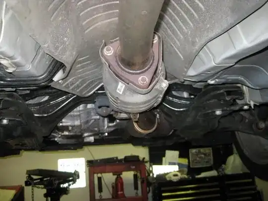

Anyone can feel free to disagree with me since I'm not 100% on this, but I believe those bumps are placed into the design in order to give the exhaust system a little more breathing room.
Note the hump in the actual body of the car above the exhaust here. This is to aid in keeping unwanted heat away from the passenger area of the car while the heat shield provides an extra layer of protection on top of the physical space around the pipe.
Dalton D
