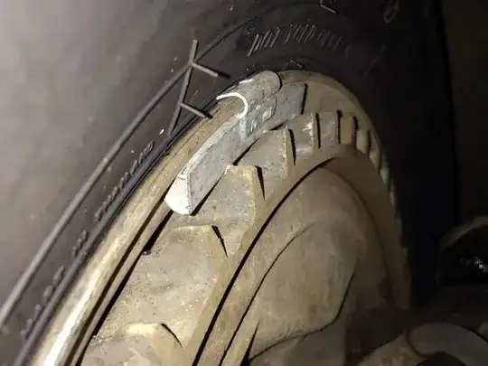

I did some looking around last night and found that some of the weights on the inside of the wheels are smashed up against the drums:
Left Front Wheel Weight
The lug nuts appear to be tight and centered all the way around, but I'm wondering whether these weights are acting as shims and at least one of the wheels isn't actually seated properly.

Vibration after new tires are installed is not an uncommon problem, and can usually be traced back to improperly weighted wheels or poor alignment. Improperly placed wheel weights would cause a vibration that increased in severity with speed, while vibration from an alignment issue could happen under any number of conditions depending on vehicle condition, suspension geometry, what is out of alignment (Left vs right, front vs rear, toe/camber/caster angles).
In your even rarer case, the vibration during braking only was probably caused by the wheel weights contacting the outside of your brakes as pointed out in your picture. As you suspected, this may have prevented the wheels from seating properly on the hubs. Why it only vibrated under braking is beyond me.
The easiest solutions would be to find lower profile wheel weights, or install wheel spacers to move the wheels further away from the brakes. From your picture, a simple slide-on 5 or 10mm Aluminum spacer would probably do the trick, though if you go any wider I would recommend hub-centric spacers with separate lug bolts already installed, such as the ones pictured below.
