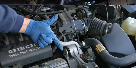

As for your motor mounts, they do tend to go bad with time and mileage. Is there any chance you can pop the hood and take pictures for us? Motor mounts and big honking things attached to your engine and the car. There's usually 4 of them, look in front, behind, left and right. Replacing these can be fairly substancial.
Here's an example of one

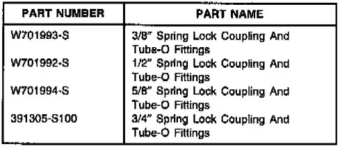

More than likely you have leaking o-rings on the AC springlock connectors.

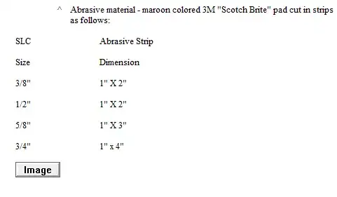

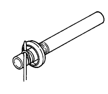

Discharge system, Replace all o-rings on all spring lock AC connections, be sure to Not score the soft aluminum when removing old o-rings. Lincoln specified thicker o-rings under a TSB (Technical Service Bulletin), so get the improved o-rings from Ford. Clean spring lock coupling connectors and o-ring grooves with maroon colored 3M Scotch Brite (cut in strips) before installing new o-rings. Re-charge system.
