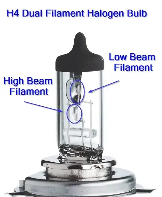

Here is an image of a dual-beam bulb. Note that it has 2 filaments as labelled:
You need to check if one of the filaments has fried. If the filament isokay for both high and low beam then you will need to replace your relay

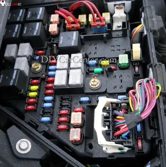

Here is image of the fuse/relay block under the hood: enter image description here
Check for the low beam as highlighted below: enter image description here
  1. Test the relay (https://www.youtube.com/watch?v=ire7vyDqelg)
  2. Order the relay if not good
  3. Replace the relay
