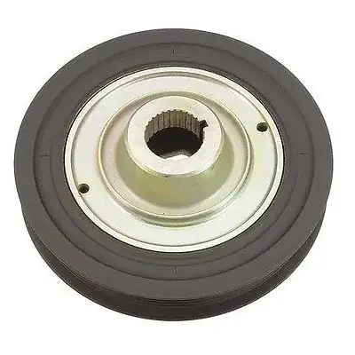

My crank pulley has splines and a key, or something -- I don't know the terminology so here is a picture:
(image source)

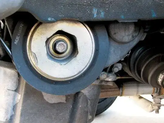

The bolt just fits on the end of the crankshaft, nothing exotic (the special tool has a hole in the middle and sits in the large socket so you can hold the shaft still while cracking the bolt):
(image source)
