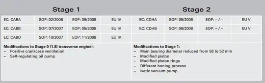

The only information that actually describes the changes technically is in this VW study material:
http://www.vaglinks.com/vaglinks_com/Docs/SSP/VWUSA.COM_SSP_436_2.0L_TFSI.pdf
This information tells me the CDHA engine supercedes the CABA engine and has changes to:
  • Bearing diameter reduced
  • Modified piston
  • Modified piston rings
  • Different honing process
  • Changed vacuum pump.
It will definitely be compatible, assuming the whole engine is swapped, but what those changes were made to the engine design for, I cannot tell you.
