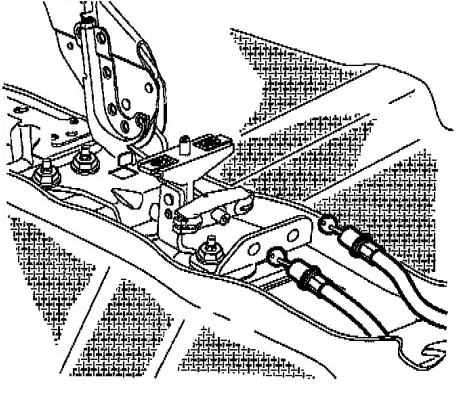

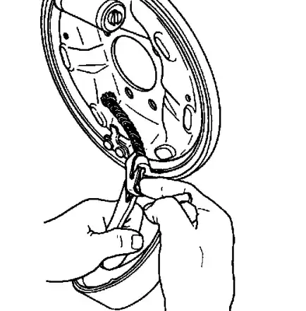

Its possible the cable got pushed out of the equalizer bar. Check cable connections on both ends of the cables, inside the drum and the equalizer bar. Also be sure the parking brake bar inside the drum is installed properly.
Equalizer bar image
Brake drum cable enter image description here
