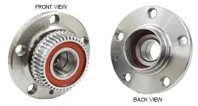

The ABS light can be triggered by metallic debris or dirt on the wheel sensor(s). The sensor tries to read the position of the nearby reluctor ring, but if it cannot then the ABS light will go on. It's also possible that one of the reluctor rings has broken or cracked, which would also cause an issue. Reluctor ring

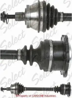

I would check the sensors and rings first, before just replacing the ABS module. Here is another picture that shows where the ring is located relative to the rest of the axle. A6 drive axle
