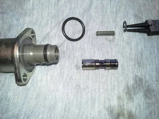

This is my replaced volume regulator, please note the slight fretting marks on the part in the center.enter image description here Those marks where enough to cause a disturbed idling and engine stopping when accelerating after longer descents.
