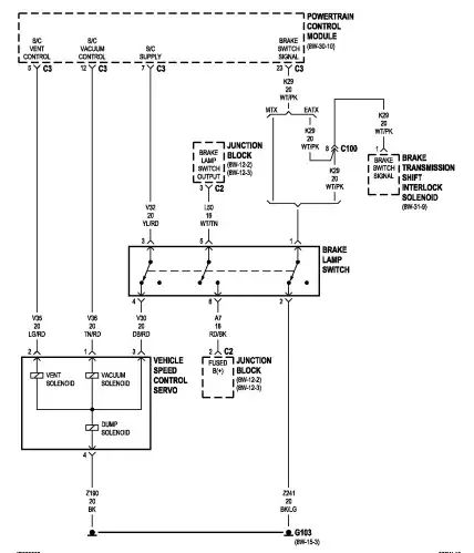

I would check the brake pedal cancel switch, it may be an integral part of the brake switch but has its own electrical contacts. If it is stuck in the open position this will cause cruise to not engage. You can check this with an ohm meter, pins 3 and 4 (first diagram) should have continuity with the brake pedal at rest, lose continuity when you depress the brake, do this with key off.

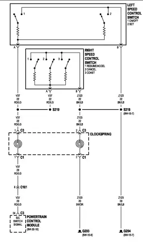

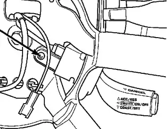

And possibly the cruise switch on the steering wheel column has failed.
Or the clock spring has failed (behind the steering wheel, this connects all electrical switches on the wheel to the harness)
