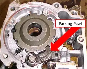

Assuming it is an automatic transmission using park is safe, there is a park pawl in the transmission that mechanically locks the output shaft, actually better than a parking brake.
The slight roll forward (or backward depending on incline direction) is normal for an automatic park pawl, the movement of the car rotates the output shaft slightly to engage the pawl.
Only downside is if you are on a steep grade it might require some effort to take it out of park due to the load on the pawl, but does not hurt anything to do so.
generic image of park pawl
