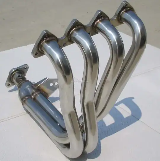

  • Exhaust header: on most vehicles, this is the best bang for your budget buck. Replace your stock exhaust manifold by an exhaust header, let the engine breathe more easily, free up some power. Generic ones can be just as good for less money. You're looking at $100 for the part. enter image description here

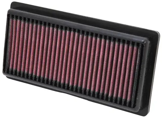

  • Performance air filter: replace your paper air filter with a reusable cartridge, good for a few more HP. Stay away from short ram intakes, all they do is look cool, but now your engine is breathing warm air. You're looking at $60 for the part. enter image description here
