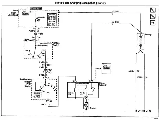

As far as my research shows the ign switch is fed form the main panel (40a fuse) under the hood (near battery) directly to the ignition switch, then goes through the neutral safety switch to the starter, no theft deterrent intervention. I have tried moving the shifter up and down the range with key in start position with no luck, so I assume neutral switch is good.
Schematic pulled from AllData, appears to be the way GM has done it for ages, if anyone has better data on the wiring please post or link to it.
I cannot do any diagnosis until Tuesday, check voltage in and out of ign switch, same for neutral safety switch, check voltage at starter solenoid with key in start position. Check Starter install and wiring.

After diagnosis it looks like the ignition switch, when it does the no crank I can hold the key in the start position and wobble the key-lock cylinder around and it will crank, its like it does not quite engage the switch when the interior temps get to a certain point, strange issue I have never run into before but think I found the problem or least narrowed it down to the switch or gears.
Qualified the neutral safety switch by bypassing it.
It is either the ignition switch or the gear mechanism from the back of the lock cylinder to the switch is worn out. Owner says the switch and lock cylinder was replaced 90 days ago but not sure of the quality of the switch. He wants a guarantee the switch will fix it but cannot do that due to the possibility the gears are worn just enough to cause it, would require quite a few hours to disassemble that mechanism to check but does not want to pay hours required, so I cannot guarantee the diagnosis without total disassembly.
