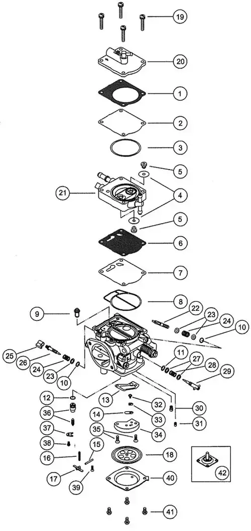

  3. There's something out of order with the pump plate, either the internal poppet valves, or the pulse metering system. Are you certain the primer bulb isn't overpressurizing the pulse area? I probably dont't have the right terms here... I'm referring to an issue somewhere between #20 and #21 on the following diagram (especially #21 with poppet "check" valves):
Mikuni SBN Exploded Diagram

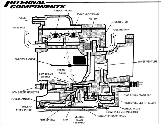

Here's a cross-ection that I found, which gives a clear view of the operation. If the fuel return is working properly, it seems nearly impossible to pressurize this area or "overprime" it, as excess fuel would simply return. Unless, of course the pulse area above the inlet is causing a problem with the valves. It might even be possible that the rebuild installed the pulse check valves upsidedown, the wrong direction, etc. Even more likely there's too much restriction in the fuel return "restiction". Here's the diagram which to me at least, gives a good clarification of the operation (from the Mikuni SBN technical manual):
Mikuni SBN Cross-Section
I hope that helps. Best troubleshooting I can do from my laptop on my first gin and tonic. Check the return flow first, and verify that flows. Easy. Luck to you.
