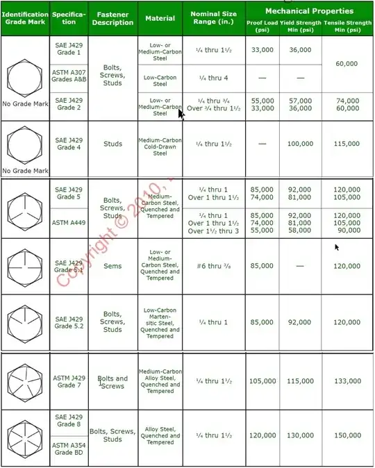

You could look up the head markings in something like this and then use a chart such as this to determine a ballpark torque figure. It may not be perfect, but it ought to do in a pinch.
Edit: I thought it would be a good idea to separate out the SAE marking and include in this answer. The jpegs aren't perfect, but they'll do.
Bolt Grade Head MarkingsTorque table
