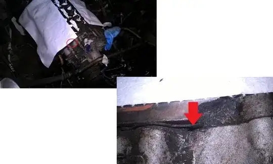

I was cleaning up the top of the engine block to put the heads back on and noticed this hole in the water pump gasket.
Also the outside of the water pump has spots on it that you might expect to see it it had been exposed to water.
Do I need to replace that gasket? The hole doesn't go all the way through the gasket. It's maybe 3-4mm deep. Could the water pump be bad and that is what caused the blown head gasket in the first place? A water pump is only $40 but I'd prefer not to do any more work than I have to.
*It might be worth noting there are some rust flakes down in the flutes (? the holes on the top of the engine block that you can look down into and see coolant) so maybe it's a good idea to take off the pump anyhow to get some of that out of there?

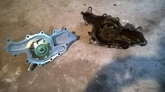

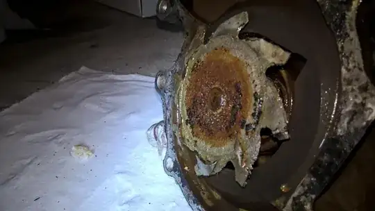

EDIT - It looks like I got very lucky. I'm not a mechanic and don't really know what I'm doing. That little gap in the gasket got me to replace the water pump, even if my motivations were wrong. Well the old water pump was WRECKED! I doubt it was able to push much coolant and maybe it was what caused the engine to overheat in the first place.

There are typically two ways to tell if a water pump is bad.
  1. The water pump won't turn.
  2. The water pump is leaking.
In the event of a water pump not turning, the belt driving it will usually be ruined so that's usually easily diagnosed. With the belt off of it, the water pump should be able to be turned by hand. If the water pump is leaking, that's also pretty evident once you've gone as far into the engine as you have.
To agree with dlu's comment, you'll never be closer to the water pump than you are now with the work you've already done. If you've successfully replaced the head gaskets then replacing the water pump should be no problem. If the pump doesn't leak and it still turns freely then you can just replace the gasket if you think the hole is something to worry about.
When that close to the water pump, you may as well just replace it since they are not built to last the entire life of the car. Most timing belt replacement kits come with a water pump as well as they go hand in hand when replacing. (thanks, dlu)
Dalton D
  • 1,968
  • 27
I think one technical proper way to test the water pump for leakage would be to pressure test the cooling system and observe for leakage When the water pump can be Visually assessible so well That test would only miss a water pump failure if the impeller is disconnected from the shaft
