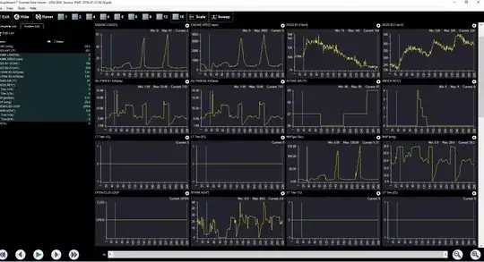

A capture of engine PIDS on a hot start. Engine MAP is high at idle, suggesting low engine vacuum.

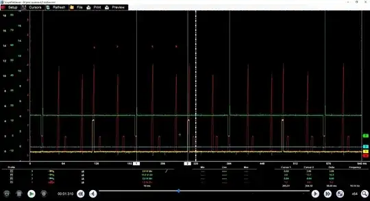

This is a capture of the bank 1 ignition and injectors at idle.
Trace 1 (Yellow) is the number one coil trigger.
Trace 2 (Green) is the number one injector trigger.
Trace 4 (Red) is the amperage reading taken at the ENG1 fuse. This powers all the bank 1 injectors and coils.
This doesn't look right...

Low engine vacuum according to the MAP sensor reading. Maybe a restricted MAP sensor port? Maybe, but I doubt it the range is too good on the PID capture. Bad MAP sensor? Another maybe. Leaking Intake? I'm pretty sure it is. There was a hissing sound but I couldn't nail down the source. I asked them to smoke test it when the engine was cold and get back to me. Valve timing? Another maybe. The P0175 may be related.
The P0200 code. Honestly I need more time with this one, why would the injector be firing so early? The timing looks off too. I think the harness connections may not be in the right spot. Or there's something wrong with the harness.

Make sure the cam and crank signals are good. Also check the reluctor for the crank and cam sensor.
