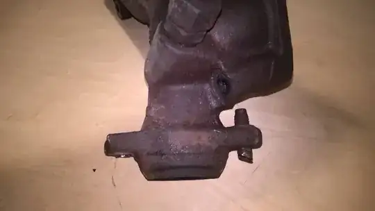

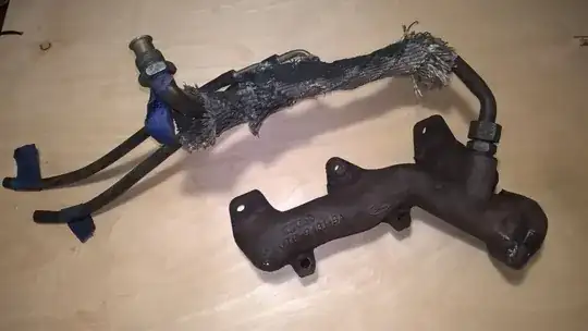

Here's the piece I'm working with.
And here's what's left of the bolts. I need to remove them both but have only cut down the one.

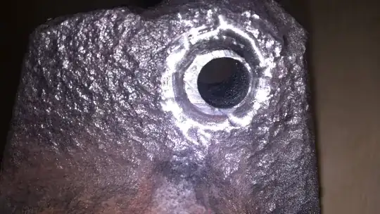

Here's a view from the side where the head of the bolt used to be.

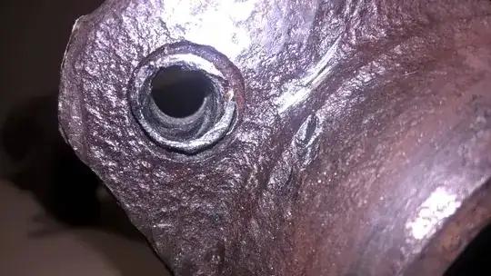

Here's the other end. You can kind of see that the hole was not dead center by the time it got to the bottom but it's not quite as uncentered as it looks there. I think the camera being on that side makes it look even worse.

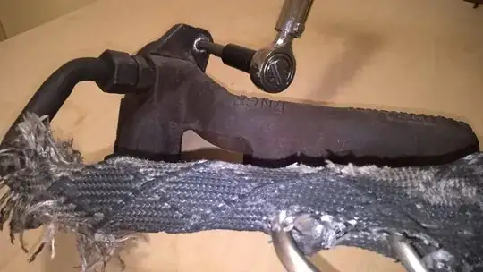

And here is what my removal situation looks like. Okay, sorry, I just realized the wrench is on the wrong side in that picture but I just stuck it in real quick to give you a general idea.
I just put the tap in, step on the manifold, and turn. This isn't ideal. I think my chances of breaking something would go down if I were able to secure it to something.
And finally, this gif tries to show that on the end that was opposite the head, the metal between the manifold and bolt looks seamless. It looks like they screwed in the bolt and then welded it the manifold. Not really, but sort of. I took a dremel around that area to see if I could find a seam but didn't find one.

There's 2 things you can do:
  1. More heat: The bolt does need to glow red-orange for this to work. If it's not glowing red-orange, it ain't hot enough. Getting a bolt that hot does take a lot of time with an acetylene-oxygen torch, other torches will take a lot longer, if they can do it at all.
  2. Drill it out: Drilling it out is your option if heat doesn't work. Sure, you could do a nut and bolt, but you could also cut new threads. Get a tap-and-dye set, select your favourite bolt size for the new threads and have at her. You may also want to use thread-locking compound to secure that bolt.

The exhaust manifold is a typical candidate for seized bolts.
You could try a pin punch to separate the rest of the drilled bolt from the manifold. Place the punch on the small circular groove visible on the photo, hammer radially, downwards from the outside, thereby warping it inwards and hopefully separating it from the manifold. If that doesn't succeed there is only the nut solution left.
For the remaining bolt: Use a hammer and a pin-punch, jolt the bolt radially just above the manifold. Make a small groove in the bolt just above the manifold, use a center-punch and hammer it tangentially in the groove on the bolt, thereby rotating the bolt counterclockwise. Additionally heating the thing would be also a good idea. If that doesn't work: Cut the bolt and drill it out, then use a nut.
Later, on assembly: Be sure to use some high temperature anti-seize compound (either cooper or ceramic paste) on the threads.
