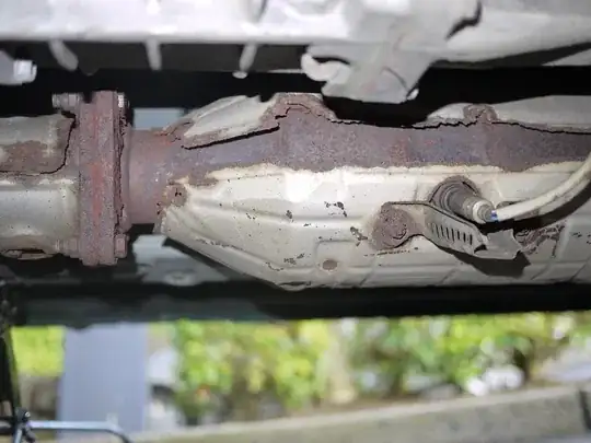

To check the heat shield, you'll have to raise the car up so that you can get underneath it and locate the exhaust system. Here is a picture of a corroded heat shield.
You should be able to move the heat shield with your hand if it's loose (do this while the car is cool, mind you). If you want an easy fix, I usually just self-tap a short screw into the loose heat shield area so that it sits snugly against the exhaust again. It's not recommended that you remove a heat shield completely without replacing it as it is actually a very useful component. The exhaust system gets extremely hot so keeping that heat contained and away from vital areas on the car is very important.
