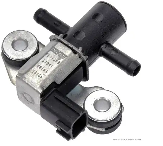

Friend has a 08/09 Nissan Rogue with the check engine light on. Ran my OBD2 scanner on it and pulled a single code, P0444, which indicates per my search the Purge Control Solenoid Valve. When I search for this my results are typically for the Nissan Altima. So is the PCSV located under the car on the charcoal canister or in the engine bay? When I do find the valve can it be ohm'd with a meter?

It's under the hood on the right side of engine compartment. Unplug the connector, figure out which side is the computer controlled ground. Backprobe the ground wire. put a vacuum pump on it and ground the solenoid. Do this when the engine is hot and do it several times.

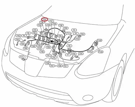

Check per tsb ntb05-053 as well. It covers harness rub through by the wiper motor setting any of 6 evap codes including p0444.
Spec on the solenoid is 35 ohms with no mention of temperature.
