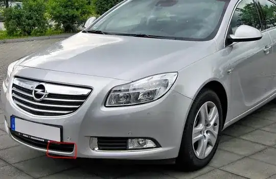

The sensor is located in the lower front grille, left side (driving direction). The sensor should be visible through the grille raster, there should be only one distinct component enter image description here
