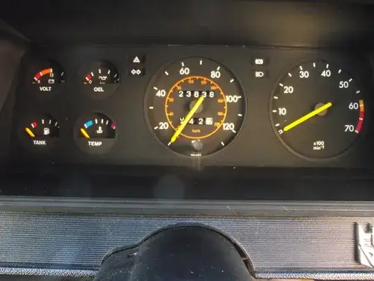

Actually you are saying opposite things. Older cars had more indicators, newer cars rely on ECU. Here's example (my cars):
Opel Manta 1981 dashenter image description here

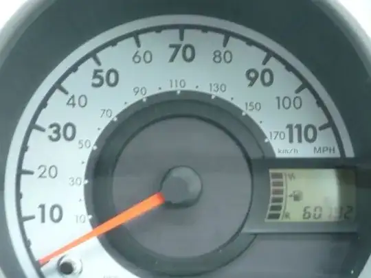

And my current car Peugeot 107 dashenter image description here
I prefer as many as possible, I want to know everything. But today you don't have to know how to fill the screen wash liquid to pass a theory and driving test. Cars are built for different needs, different people.

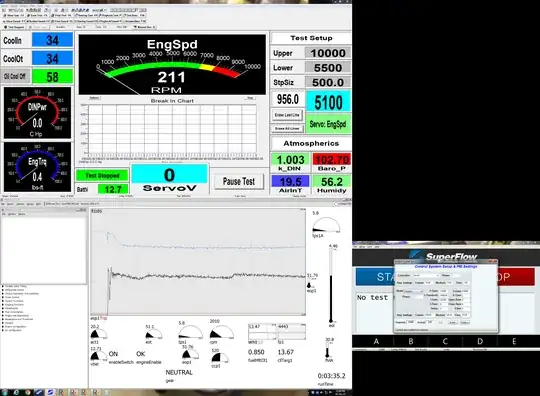

And here is my dashboard when I test the engines..enter image description here
Sometimes we see a new topic where people are concerned about driving at 70 MPH at 3rd gear... If she had Tachometer, she probably would notice that. Sometimes in a busy traffic your cooling might fail and start to go over 100 degree C..
