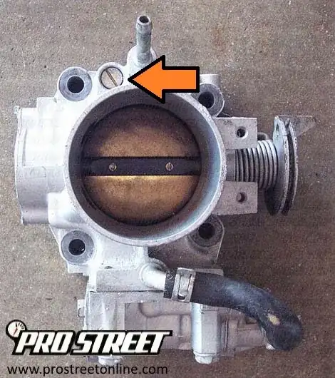

The engine has no power at idle, it would be same as if you switch in gear and slowly release a clutch. Automatic idle control will try to keep it running, and it will vibrate. Some tiny 1L cars with AC needs to turn the AC off to get up the hill. It's a big load. If your idle revs are going lower with AC ON, then you can consider about checking the idle speed. Different cars have different idle speed, depends on a crankshaft and flywheel inertia.
To increase your idle speed you just need to open a bonnet and grab a flat head screwdriver. Warm up your engine, find a throttle body, and screw in this screw maybe 1/4 of a turn. See how it sounds then. You might need to screw it even less than 1/4. enter image description here
I stole a pic from another web site, supposed to be your car model throttle body and screw location.
You will notice your worn engine mounts if your car is shaking you forward and backward, making you bang your head to steering wheel and headrest, just because you're slow and almost not touching a throttle pedal. But rediculously vibrating engine is a too high load at too low RPM.
