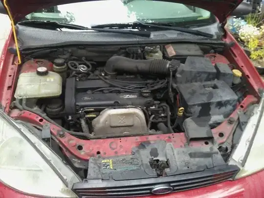

I am trying to clean the engine bay of my 2002 Ford Focus SE, which is really grimy thanks to years of neglect, and a valve cover gasket leak that I recently fixed.
photo of dirty ford focus engine bay
I have been reading about how to clean engines properly, but am seeing some conflicting info. Some people are just spraying degreaser, and then using a brush and garden hose to clean. Others say that it's super important to cover all electrical components with plastic.
My questions are:
1) Which engine components besides the alternator, electrical connections, and battery do I need to protect from water? Are there any mechanical components that need to be protected or plugged off? I was just going to duct tape some plastic grocery bags around things to keep them dry. Does that sound adequate or is there a better way?
2) How long should I let it dry before driving it?
3) Any other tips for cleaning that will minimize the risk of damage?
Thanks!

I went ahead and cleaned the engine, and so far (after a couple of hours driving around today), everything seems OK. Before applying degreaser and washing, I disconnected the negative battery terminal and wrapped the following parts in plastic grocery bags + duct tape:
  • Battery
  • Alternator (hard to get to without removing power steering / coolant reservoirs)
  • Fuse box
  • Ignition coil
  • MAF sensor plug (the big electrical connector between the air filter + intake hose)
  • ... and other assorted large/exposed cable connections + electronic devices
After covering these parts with plastic, I used detailing brushes to cover everything with a mixture of 1 part Simple Green degreaser/cleaner to 10 parts water. I used enough that it flowed down over components lower down in the engine bay. I let the cleaner sit for several minutes, and then gently showered it all off with a garden hose nozzle. I repeated this process several times, each time using small brushes to agitate the thicker areas of grease/dirt and scrub in the degreaser.
One problem to note with this particular engine is the recess in the valve cover, where the spark plug boots are inserted. This filled up with water when I hosed everything off, and the water slowly seeped through the seals on the boots, and dripped into the spark plug wells. Fortunately, it seems like the plugs prevented the water from actually getting into the engine, and no problems have resulted (so far). But I did have to take towels and soak up all of the water from around the plugs, which was time consuming and frustrating. In the future, to prevent this, I will just seal this entire part off with plastic + tape.
Anyways, I'm pretty satisfied. The engine still has a lot of grime on parts that were hard to reach with a brush, but it's much cleaner to work in and I can see everything better.
