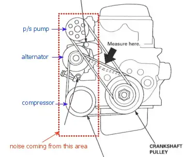

The sound has been going on for a few months. I can't pinpoint the source vertically, but it's definitely coming from the ps pump / alternator / ac compressor area (all three are on top of eachother in this car):
It doesn't seem to be the belts themselves (there are two, driven by crankshaft, one for the p/s pump and one for the alternator + compressor); the consistency of the sound's sudden start / stop seems to rule that out.
I don't think it's the compressor; the sound is independent of whether the a/c is on or not. I also don't think it's the p/s pump, it's independent of the steering state.

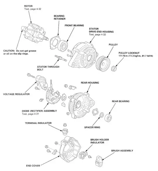

If it is the alternator, I can't figure out why it would make that noise. I don't really understand how they work. The belt is always turning so I'm not sure why the noise wouldn't just always happen (assuming it's the alternator).
If it's useful, here is an exploded view of my alternator:
Is there something in the alternator that starts and stops spinning even while the input shaft continues spinning? I don't see any kind of clutch-looking thing in the diagram.

Try this: get a water spray and a friend that can help you to rev until the noise comes in, then start to spray one suspecting item, say, the alternator's pulley/belt. Just a bit of water there...and do with the rest if you don't see the noise disappear. What you will be doing is to lubricate the pulley with water, so the belt won't squeal. This is a very simple way to find slipping belt noises. Inside the alternator, there isn't anything that can mimic the sound of a squealing belt. Neither inside the a/c compressor. Those would produce other noises, aka, "grinding" because their bearings going bad...Other test could be if you unbelt the power steering pump, that will at least narrow the suspects.
