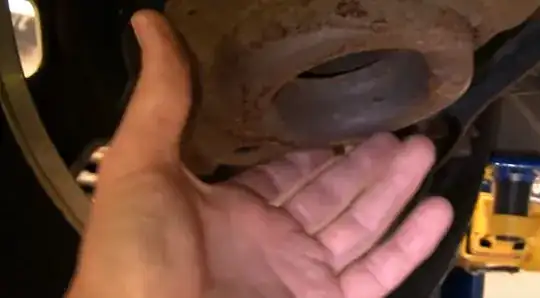

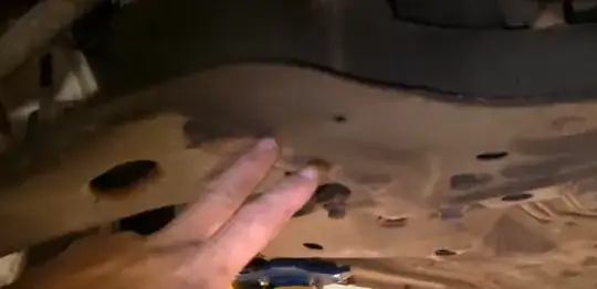

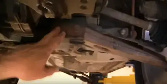

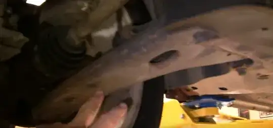

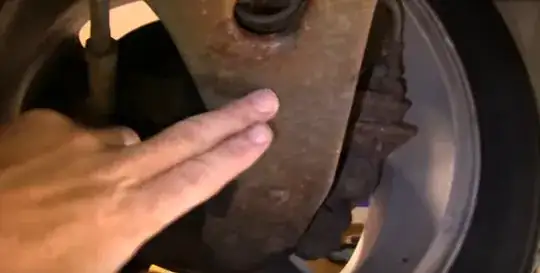

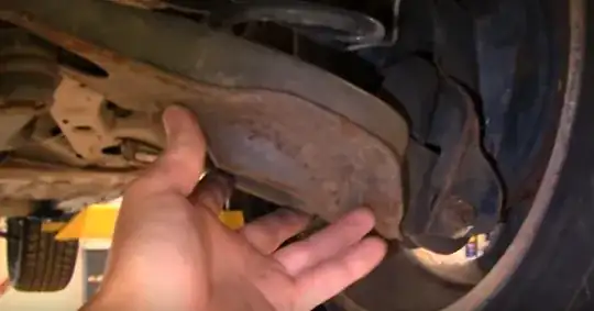

Here are the places that you can place the jack on:
Rear left wheel
Rear right wheel
Front left pic 1
Front left pic 2
Front right pic1
Front right pic2
