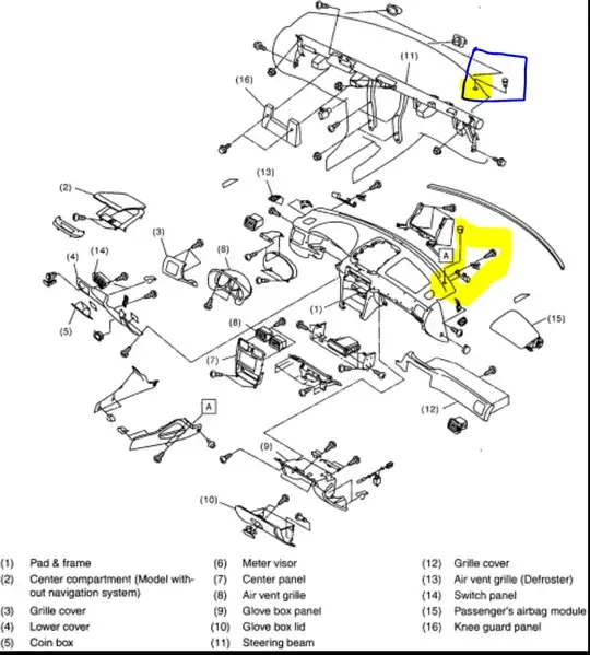

By the way, the mechanic did disconnect and drain the AC system while he was working on the car -- I do not know why he did this although I think it was a mistake since I was not charged for this. The AC works fine now as it did before.this link shows where the sensor is that the mechanic pointed me to on the dashboard of the passenger side. enter image description here

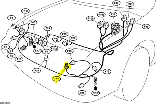

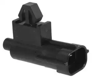

Sounds like the temperature sensor is broken. A new one is $40-$55, and it's a 30 minute job to replace if you've never done it before (it lives behind the grill in front of the radiator). Not uncommon for these to fail on Subarus and give weird readings.
Following Paulster2's comment, here's an image of what the sensor looks like;
Image from http://www.autozone.com/emission-control-and-exhaust/sensor-ambient-air-temperature/duralast-sensor-ambient-air-temperature/179833_0_0/
In this image (of a 2007 Forester), the sensor is in the yellow outlined location.
