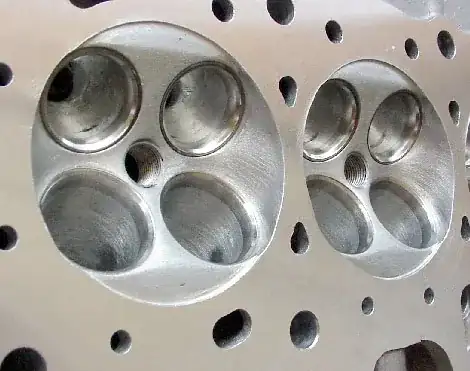

If you are only talking about the combustion chamber, by far the most used material is aluminum. The combustion chamber is part of the head. It is just the indentation where the valves reside. The combustion chamber affects flame propagation. In the past, besides aluminum, cast iron was used as head material. Cast iron, while being more resilient than aluminum, is harder to work and weighs more. Aluminum also dissipates heat faster than cast iron.
In the picture below, you see the head and two combustion chambers. They are the round indentation in the head. The four round holes in each combustion chamber is where the valves reside. In this case, you have two intake and two exhaust valves. Around the edges of the holes for the valves are valve seats, which are usually made of cast iron, but can be made of other material as well. These are harder and can stand a lot more abuse than can aluminum by itself. In the center of the combustion chamber are the threads for the spark plug.
