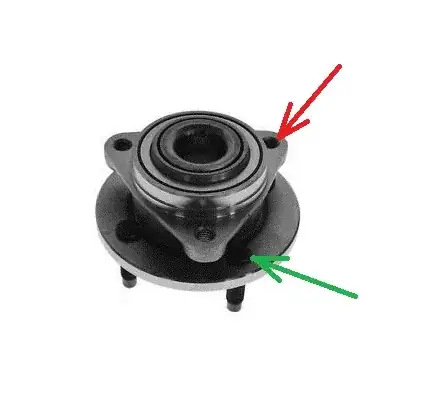

if it is since you have replaced a hub and bearings, on the same wheel, then all you can do is to get the wheel off and look for a reason. Maybe a new hub wheel studs touches something. Looking now for your hub in Google, and looks like it might be the bolt that holds the hub (3 bolts, red arrow) touching one of a wheel stud (green arrow). Or just any other similar issue, sometimes a brake caliper touches something because it is a moving part, you can never know....
