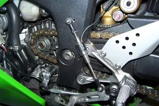

The quick-shifter is usually a sensor reading the position of the shifter, informing a microcontroller of when up-shifting takes place in order for the controller to cut the fuel/ignition. It looks something like this:
Quick-shifter on a ZX10
Image courtesy of Kawi Forums

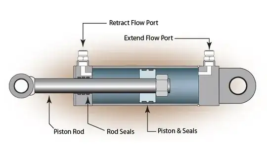

On the racing car - Upshift cuts the ignition, Downshift blips the throttle. Details: instead of gear stick they have paddle shift. It is a actuator attached to a gear selector and being pushed or pulled by compressed air or solenoid. Compressed air comes from a little compressor mounted on a car. When you switch gears up you send a signal to ECU which is programmed to open a solenoid valve and fill the actuator with a compressed air and push a gear selector. At the same time it cuts the ignition so the gears becomes loose for a time of eye blink. When you switch gears down, ECU opens another solenoid valve to fill the actuator from the other side to push it other way and also opens third valve to blip a thottle. It is another small actuator fitted on a throttle cable, which might be run by compressed air or a powerful solenoid. Also gear position sensor tells the ECU which gear it is going to be so it doesn't blip or cut when you try to find a neutral..
Actuator - the picture shows pneumatic (air) actuator, but it also can be a powerful solenoid. Actuator
