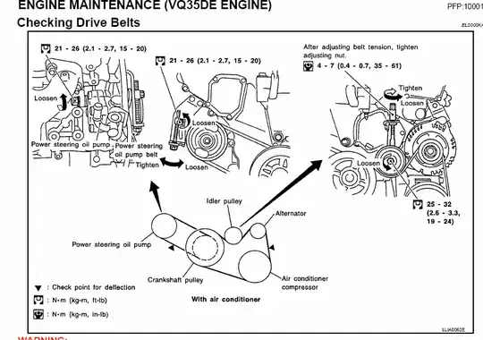

Pulley diagram
If you don't have a stethoscope or a screw driver or similar that you can use as one. Pull the belt off, put some tension on one pulley at a time and spin them by hand any roughness indicates bearing/bushing failure.
You can probably rule out the compressor pulley as the noise doesn't change as the clutch engages. Idler pulleys are the most likely to fail first. A water pump has a deeper sound when they go bad and usually leak. It doesn't really sound like a harmonic balancer either, usually when they go bad the rubber will separate and cause a screeching sound.
It will probably end up being the alternator or idler pulley.
