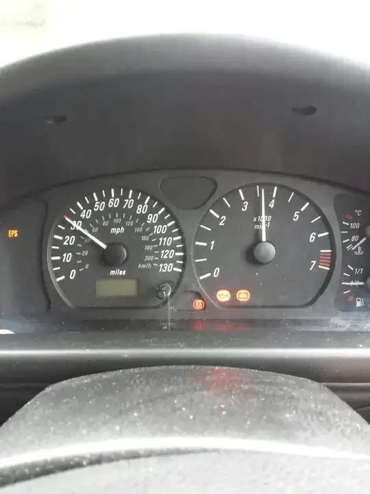

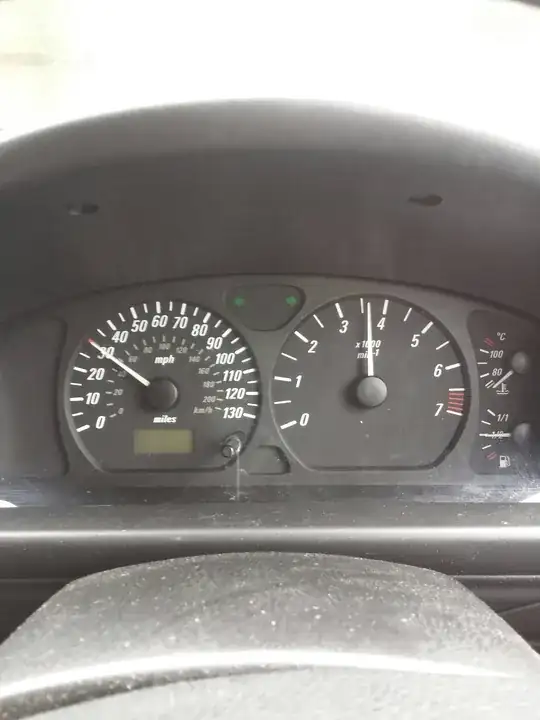

I have just broken down. I am safe. My car has suddenly cut out and my instruments are frozen. The car will turn over but it refuses to start. My fuel gauge is stuck as well. My engine is cold so I do not know about the temperature gauge
This is with the key removed from the car.
When I turn to run, with the warning light test I get NO emissions lamp or engine warning light. My odometer does not work either. I get a blank screen. I get the EPS lamp, the airbag light, the oil and battery lamp (when the keys are in the engine run position). The airbag lamp goes out after a while as in this photo.
My car is a 2003 Opel Agila 1.2
My clock and temperature display in the centre console does not turn on at all either and neither does the radio. It appears that no power is getting to them. My battery is fine I think as the car turns over. This happens no matter if the key is in or out of the ignition or what position the key is in the ignition
