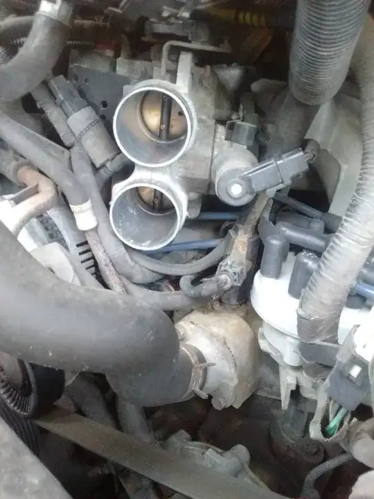

In case a picture helps:
Intake manifold
Like I said, I've been looking for quite a while, and I can't find anything. Thanks!

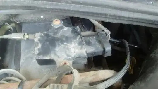

Instead, it has a MAP (Manifold Absolute Pressure) sensor, which looks like this:
MAP sensor

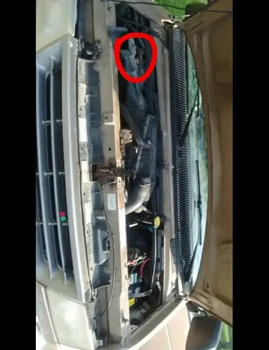

And can be found here:
Where the MAP sensor is
