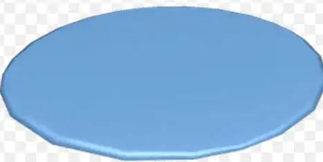

Several answers complain about thickness (number of coats). No, that's not your problem either. It may be good advice for painting, but it will not help you. You just need to make sure that the last layer is thick enough that the droplets combine on the surface.
Bad final top of top coat layer which will result in orange peel you'll need to sand:
Good final top of top coat layer which you won't need to sand and is best:
(The density of paint droplets needs to be enough that they combine.)
