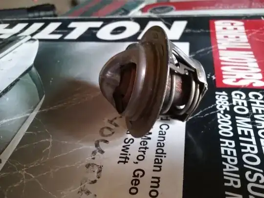

I used this procedure to install and remove the thermostat from the chilton book
Pic of old thermostat enter image description here
this is after getting answer. So found the sensor near/at thrermostat housing. one wire comes of it. grounded the sensor to the chasis with alligotor clips. Flip the key swittch on/off and it did climb the temp coolang gauge to hot.
actually after just messing with the connection it started to work alone. It was just corroded! :) the outside sensor's connnection
