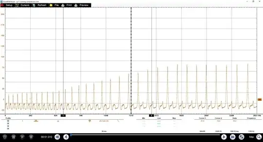

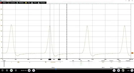

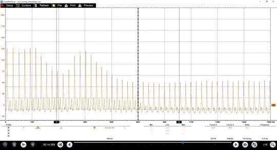

Cylinder 1 running compression idle to WOT:
The end of the exhaust valve event where the intake valve opens looks weird.
Zoomed in:
It doesn't look right but what do I know?

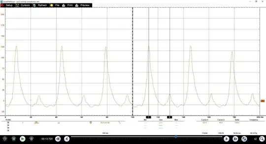

Cranking compression @ WOT:
OK... how about running compression?

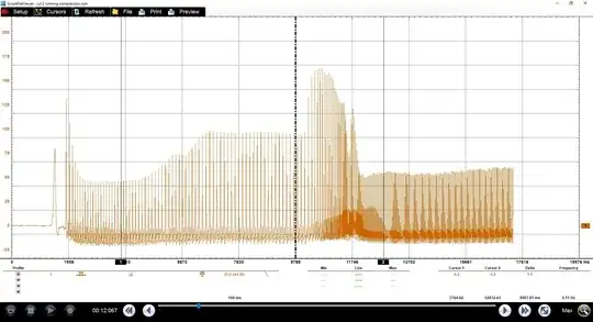

Cylinder 2 idle to 3000 RPM to WOT zoomed out:
Let's zoom in a little...
Still seeing a pressure spike at the end of the exhaust stroke.

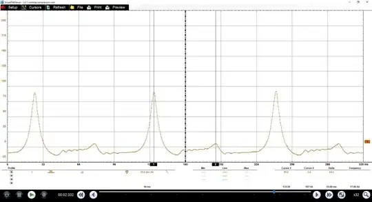

Zoomed in on the WOT portion:

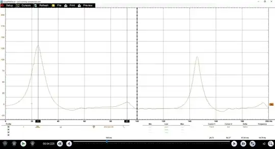

Zoomed in at idle:

So, in pictures 1, 2, 5, and 7 what exactly is happening when the intake valve is opening and the exhaust valve is closing? Is this because since both valves are open and the piston is at TDC, it's sucking more air out of the intake manifold and results in the pressure spike due to the exhaust being potentially plugged?
In picture 6 this is kind of what I expected to see with a plugged exhaust. Would there be another explanation for the pressure spike?

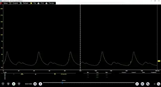

In pictures 3 and 7 why are the exhaust and intake events almost the same? It looks like it's slowly building pressure.

Confirmed exhaust backpressure with a gauge, around 3 PSI @ idle and 8 PSI @ 3000 RPM.
Did another in cylinder capture on cylinder 2. Even with the o2 sensor removed the waveform was similar to picture 6. Very puzzling.

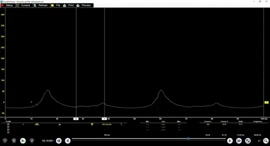

After repair @ 3000 RPM

I did some searching on IATN and found known good pressure waveforms that are identical to my after repair captures. Unfortunately I can't post them here. It turns out that hump is completely normal.
After doing more captures on different cars with VVT I've found that most waveforms are unique to some degree. I guess the same can be said about non VVT engines based on the camshaft profile. Though they do look pretty similar.
