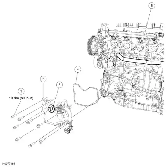

The Haynes manual is correct you need to remove the intake to access the PCV valve.
The hose from the valve cover to the intake tube is a breather hose.
The valve in question.
