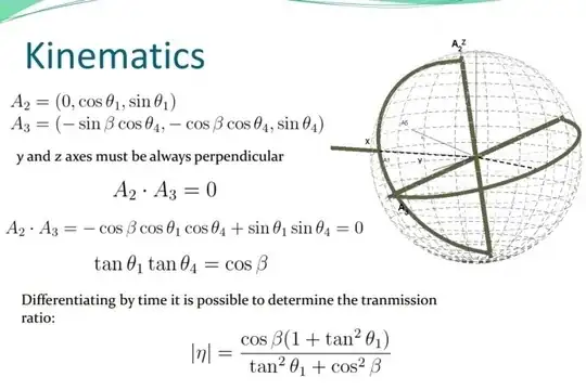

Update #2: Here's a pretty detailed reference, from Dario Governatori University of Rome Tor Vergata. Look at slide #13, Kinematics. The author creates a relationship for each half of the u-joint cross, based on the angles of the input/output. He takes dot product = 0 as they are perpendicular to each other. Substitute angle inputs, and then differentiate the relationship of the input and output angles with respect to time. That makes sense but certainly is not intuitive. I think the overview illustrations here are excellent.

I will say, I found the "Equation of Motion" description in wikipedia much more complete and easier to understand (even if the wiki illustrations are a bit weak.) Using both references together makes things much clearer.
