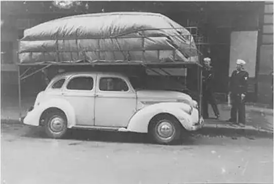

People continued to invent gas powered vehicles, in the second world war there was a brief revival.
The vehicle pictured is using some gas other than hydrogen gas, but you can see the point I'm making.
