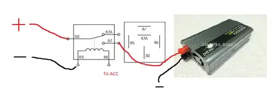

I'm concerned about leaving the inverter on when the car is parked and draining the battery. How hard would it be to wire the inverter so that it is only enabled when the engine is running, or at least when the accessories are on?
For a 500 W inverter you should use a relay rated at 50A minimum (see resident_heretic's calculations). The schematic should be pretty simple:
Should the inline fuse rating match the inverter rating, or are there other factors to consider?
The fuse rating should be lower than that of the relay.

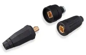

What type of connector should I use to allow quick (safe) disconnect of the inverter leads so I don't have to take the ring terminals off the battery.
Welding tools use these:
They come in different sizes. The smallest will do just fine for 50-100A.
