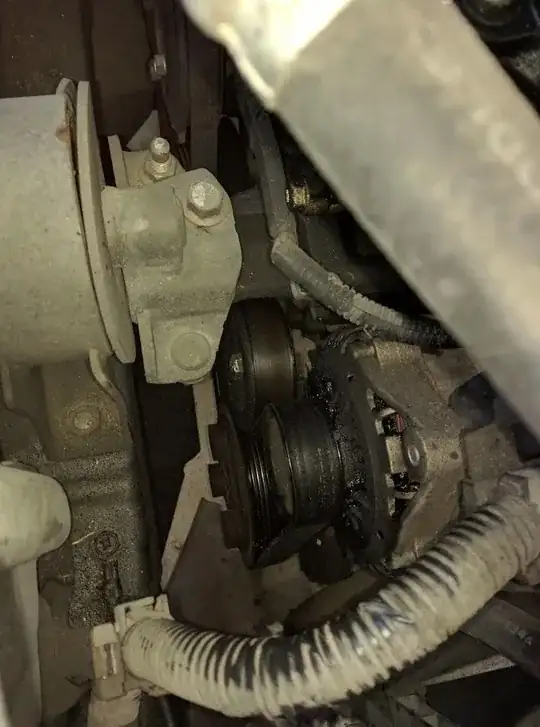

I am trying to remove the Alternator on my Nissan Sentra 2001. I believe I need to take the alternator belt off. It's tightly on the pulley - see picture enter image description here
How to make the belt loose? I am told that there should be a tensioner bolt head and it has a very long thread which screws into the backside of the center bolt/nut that is 90 degrees of the center bolt/nut but I cannot find it.

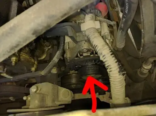

Is it in this picture?

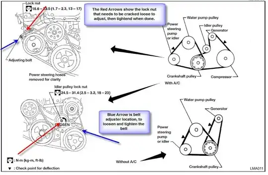

Based off this diagram, the adjusting bolt is not present in the pictures you provided:
Nissan Sentra 2001 Belt Diagram
It looks like your Sentra has air-conditioning, which means that your belt tensioning mechanism sits above the power steering pump (leftmost belt-driven component).

Different year same engine.
Your image
Loosen the idler pulley nut. And per the posted image loosen the adjuster to remove the belt.

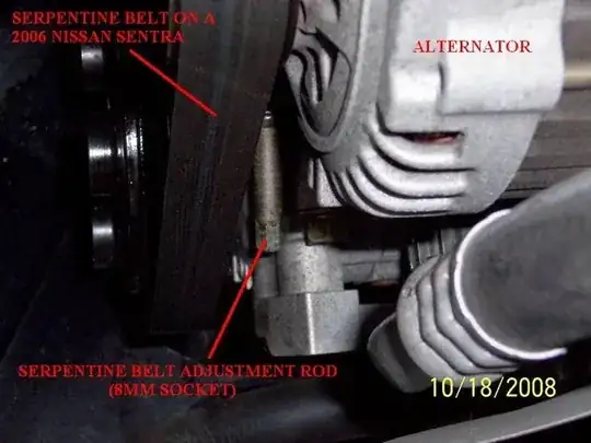

Yes the tensioner is to the left of the alternator - in the pictures above. Slightly loosen the main bolt on the tensioner - not too much. This will allow you to loosen the adjustment rod BEHIND the tensioner, which creates slack and loosens the belt. You should be able to see it - it will look like a threaded rod. Probably a good time to replace the belt and the tensioner, while you are in there... I know that is normal procedure on most vehicles... and the oil leak if possible. Oil will degrade the belt over time.
http://www.instructables.com/id/Adjusting-Nissan-Sentra-Serpentine-Belts-1/
