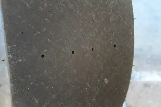

There are wear indicators on the surface of the tire, they look similar to a drill hole, when it is to the bottom or non existent, the slick is worn out, also check for even wear across the surface from side to side.

On a typical tire with grooves, you can measure the tread or check the wear marker bar.
On slicks, where there are no grooves, you can't measure the tread, so other means are provided, such as the "drill hole" looking wear indicators.
