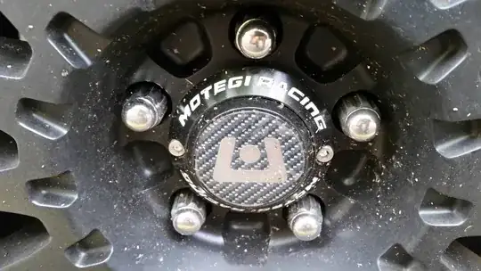

I'm looking for some help identifying the Lug Nuts that came with the wheels I recently ordered and had installed on my car. The purpose of identifying them is to be able to go get the proper tool(s) to be able to remove them in the event of a flat.
I'm not sure if I'll be able to go pick up said tool(s) at a local Auto shop or if I'll have to order them specifically from somewhere. Hopefully the picture below will be sufficient to identify them. The wheels are Motegi MR119 ordered from TireRack.
Motegi MR119 Lugs
Edit: As per a comment below, I counted 8 "valleys" which I believe would make 9 "teeth" on them.

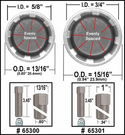

These would appear to be "McGard 8-spline" lugs. I don't have direct experience with them, but they appear to come in two sizes:
Image from BrandSport Auto Accessories. Never used them, but they had a good diagram.
These lugs are commonly called "spline" or "tuner" lugs. They are sold to look sporty (because they are different and cool), provide better torque without damage, and for additional security.
If you have a specialty car shop that sells custom wheels and accessories they might stock something like this, but I'm not sure you would find it at a national parts store. Of course now that you know what it's called you can figure it out.
