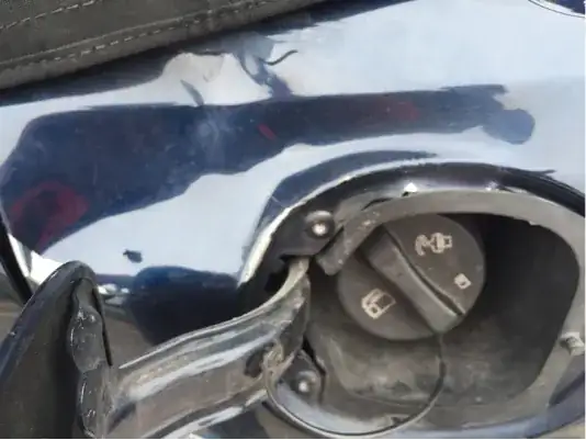

Vehicle: the ever-present 2006 Solstice with aftermarket turbo.
When I lift after hard acceleration, I can smell what I think is gas for a few seconds. It dissipates quickly, but is disturbing.
A few days ago, I popped the hood and noticed one of the 10mm bolts holding the fuel rail down had worked it's way loose by about 1cm. I know I tightened that bugger when I put the engine in (about 2000 miles ago).
This morning, I put gas in the car. While the pump was running, I opened the passenger door to clean out some trash from the floorboard, and noticed the gas smell inside the cab. I had not noticed this before I started filling the tank.
During an apocalyptic hail storm a few weeks ago, the driver's quarter panel was hit by a softball sized chunk of ice moving at terminal velocity, just to the left of the gas cap. (Close enough so that the gas cap door doesn't close.)
I've seen a "check gas cap" warning a few times on the DIC.
Also, when coming to a stop, frequently the engine will rev up to 2000-2500 rpm for a few seconds.
I noticed my BOV sticking open. Car off, BOV shut. Car on, BOV slightly open. Rev engine, get out of car, BOV open about an inch.) Thinking of putting a heavier spring in.
Suggestions? I'm not even sure where to start. Despite the damage near the gas cap, I don't see any cracks. The fuel rail and line look fine.
Help.

Depending on the design of the turbo kit and installation, it could be due to the turbo blow off valve, if it is vented externally and not back into the intake upstream, you could smell gas briefly when it discharges turbo pressure on a hard deceleration.
