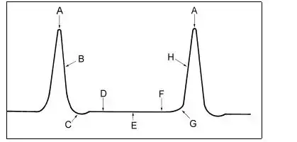

I have taken picture and its explanation from a Snap on product catalogue which I thought was well explained.
A—Ready Position
— Piston has stopped at TDC
— Cylinder contents are compressed
— Both valves are closed
— The spark pulse usually happens 7 to 10 degrees before the peak pressure.
B—Power Position
— Both valves remain closed
— Piston has rapidly resumed movement
— Piston reaches top speed at the halfway point
— Piston quickly decreases in speed and stop at the end of the stroke
C—Vacuum 1 Position
— Piston has stopped at BDC
— Cylinder pressure has dissipated, and the rapid downstroke of the piston has drawn a vacuum in the cylinder
— Exhaust valve is ready to open
D—Exhaust Position
— Exhaust valve has opened
— Piston expels cylinder contents through the open exhaust valve
E—Zero Position
— Exhaust valve has closed
— Intake valve is ready to open
F—Intake Position
— Intake valve has opened
— Down-stroke of the piston draws air into the cylinder through the open intake valve
G—Vacuum 2 Position
— Intake valve has closed
— Piston down-stroke has drawn a slight, non-detectable vacuum in the cylinder. (A closed throttle registers a detectable vacuum.)
H—Compression Position
— Cylinder contents are compressed on the piston upstroke

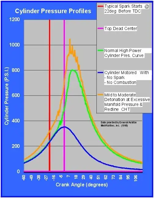

In cylinder pressure sensors are useful in finding knocking or detonation accurately.
Detonation is unwanted combustion which happens when hot air pockets with fuel are auto ignited and the yellow pressure curve with jagged ends at the top explains it clearly.But capturing this requires some high speed data acquisition hardware modules which are very expensive, which is why only well funded companies like OEM or F-1 teams have access to such sophisticated piece of equipment.
