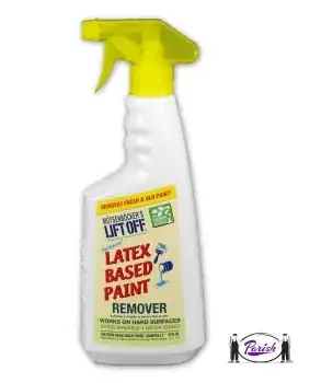

There are products which can remove it for you. Here is an example, though I don't know if it will specifically not damage painted surfaces, as it states it is for hard surfaces. I know there are also some wipes out there which will do the same.
Of course, once the latex is dried, it becomes much harder to remove. You'll also need to consider replenishing the wax coating onto the surface of the paint, as whatever you use will be sure to strip all of it off, leaving the surface unprotected.
